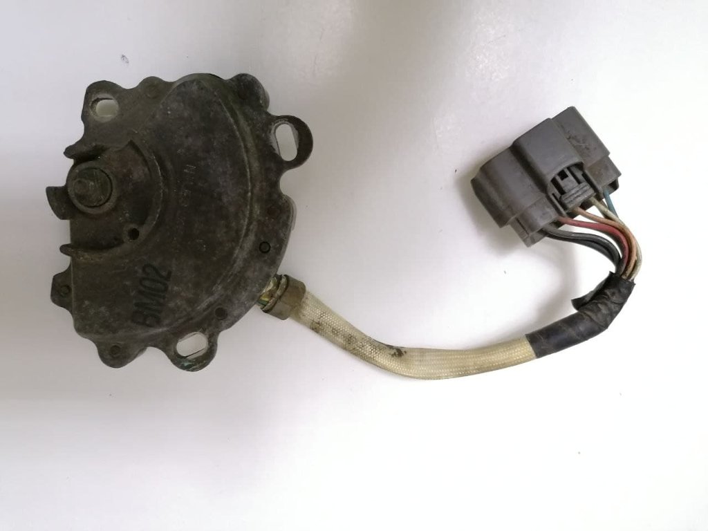

Hi all,
I have an error code 38, found that error in 2019…as the bongo running fine except that sometimes it doesn’t start on P position (Parking),
it starts on N position (Neutral).
I couldn’t find what the error code was…
I bought a Gearbox Inhibitor Switch in 2019 as I made some research, and the problem was that for not starting on P position…
didn’t went around to fit it…
(does anyone changed the gearbox inhibitor switch...how difficult is to change it?)
Any idea about this error code 38 is?

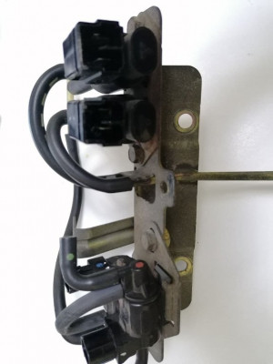

Last year I have changed the follow, thinking that could cure the problem…

Posts: 10944
Re: error code 38...any advice please...
Post by g8dhe » Thu Sep 23, 2021 9:18 pm
Try a Google search https://www.google.com/search?q=mazda+error+code+p0038
Do you have a sensor in the exhaust system thought they were only in petrol engines but ...... see here https://www.igmaynard.co.uk/bongo/forum ... 83#p589183
