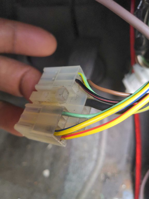

I, however, assumed incorrectly from reading various sources, that the drivers side may have had the loom but, unfortunately not. I figured out though from the difference in the wire size and some wires that were present on the fused side of the plug but not present on the connecting plug side the two control wires. from memory ,red and orange, but not the power. I made up a 3 wire loom and took a light green cable which was 12v. This worked from the dash switch raising and lowering both drivers side blinds. But the individual switches did not work. The strange thing is that I do see +12v and -12V from the switches on the two pine motor wires when disconnected from the motor as I toggle up and down, but when I connect the plug to the motor this drops to 0v when pressing the up down rockers.

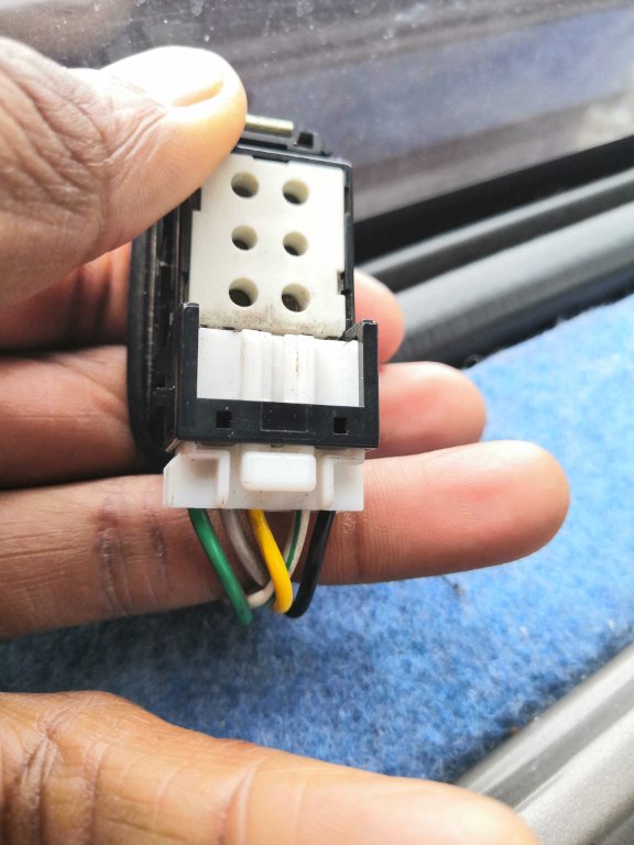

I wonder if anyone could please confirm the colours of the 3 wires from the front of the car on the drivers side please, or perhaps advise of the colours going into an individual switch left to right with the group of three pins first then the 2 pins on the right side . I have attached a picture from a passenger side switch for reference, pin 1(green and red stripe), pin 3 (yellow +12v) and pin 4 (white with green strip) are the pins I am enquring about specifcially but on the drivers side individual switches.
I would really be grateful if anyone could pop out a switch and check please.

The plug for drivers side, control wires are yellow with blue stripe and yellow with red. The green in that same block is +12v but appears to be wired to something already.. but tapping into that works for front dash switch, but not the indiviudal switches.

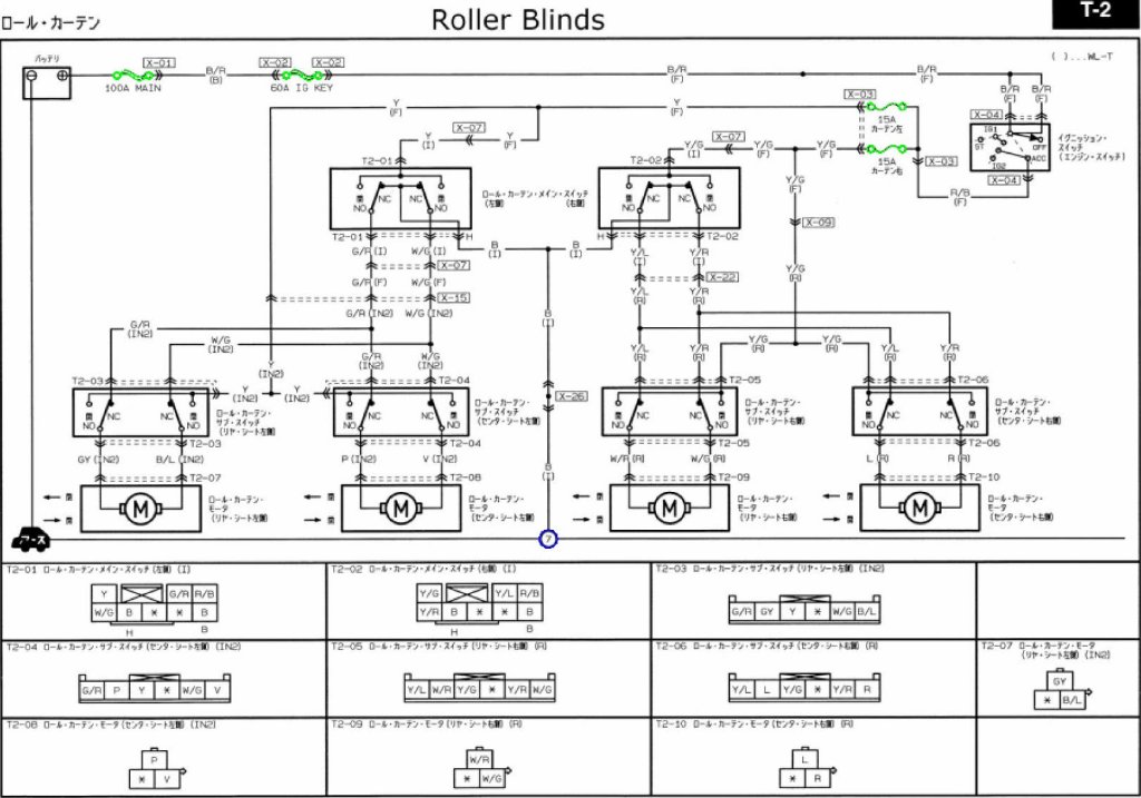

No not quite as simple as that, the motors need a full reversal of wiring to operate Up/Down hence the problem, here is the circuit to use;

Many thanks for this Geoff I will take a look at that wiring.
The individual switches do work if the circuit is powered from an independent / isolated supply, the voltages are reversed correctly and the blinds operate in both directions from the OEM switches.
I can see from the circuit diagram which wire it is I need to locate now though. Thats very helpful.

Hi Geoff, just to let you know that the blinds are working sweetly now.. Was just one other I needed to tap into...
