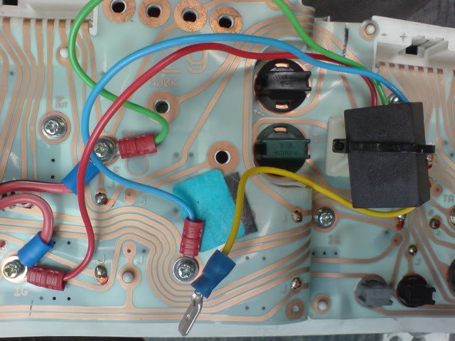

The Speedo chip is just a little module with 4 wires connected to the back of the cluster itself and yes they fail on a regular basis!
As I recall Red and Green are power and the Blue and Yellow intercept the original signal from the sensor, to reinstate just put the wire that connects to the Yellow back on the Blue tag location leaving Blue and Yellow out of the circuit completely to test. Different versions of the module will probably use other coloured wires so be aware of locations they connect to and I would suggest taking pictures before and after so you can reconnect easily!

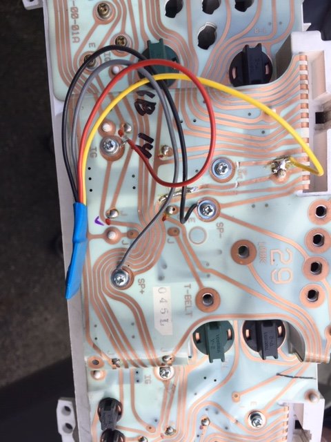

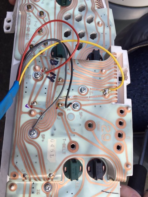

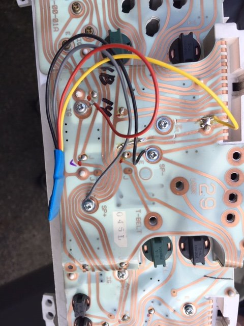

Hello, I finally got round to taking a look at the Speedo chip today... the electrical circuit looks a bit of a mess (photos attached) - can anyone see an obvious issue? Could it be worth replacing the chip of should I try to replace the whole circuit (if so, where would I get one from??).
My other big problem is that when driving for any longer than an hour the glow plugs light will flicker and the engine will do a little hiccup and lose power. The glow plug light doesn't stay flashing. Is this likely to be an electrical issue rather than an engine/gear box issue?

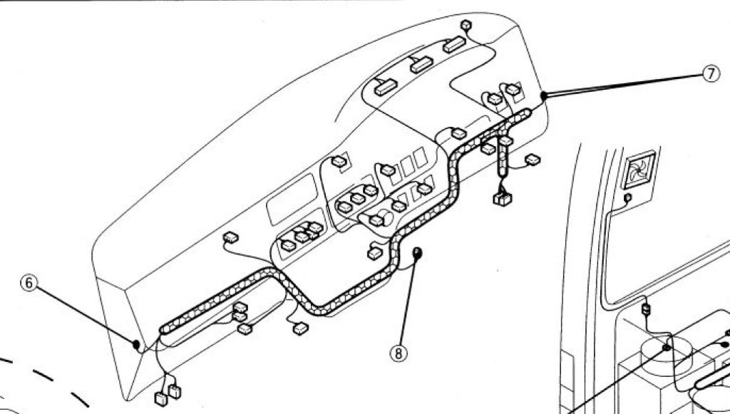

Also @Geoff, on one of my previous posts you mentioned earthing point 7 with a diagram attached but I can't zoom in on the picture to check the location - would you be able to re-send please?

The location 7 for earth is under the righthand end cap of the dashboard I believe (long time since I looked!), open the drivers door wide and there is a plastic flap that clips in position see here;
