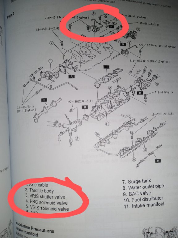

The item you have circled is the PRC and is just a simple valve operated by the solenoid. Which is the three port one you refer to ?

This little beastie
