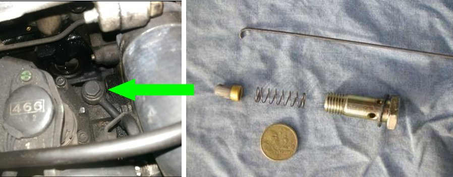

Post by g8dhe » Fri Jan 21, 2022 8:06 pm
This is the Banjo filter and location;
On some it has been removed, which isn't always the best idea, its the final very fine filter before the engine itself, be careful getting it out and then wash out with fuel etc.

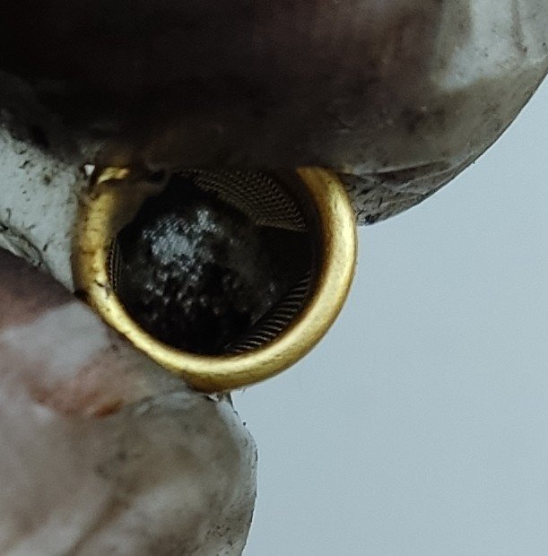

Post by sotal » Fri Jan 21, 2022 9:32 pm
I'd second the banjo filter. Mine blocked up after changing the fuel filter so it was restricting the flow.
Easy to remove to check, this was mine. I'd had no problems before changing the filter so it must have disturbed bits...

Post by trikeboiler » Sat Jan 22, 2022 12:55 pm
Hi thank you for your info. It was the banjo filter that was full of muck, cleaned it out and it started first time and runs great now. Cheers all.
