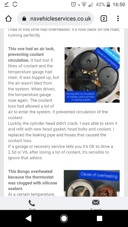

Photo of cylinder head attached. Apparently it is not cracked, which is good news. My research points me in the direction of a massive air lock, if you spot the similarities in the two attached photos.

Theres your problem, looks like the self bleed kit didn't work too well, was it a 'rusties'? If so you just saved me fifty quid.

Yeah the CH does look very similar to the smaller pic of the other one.
