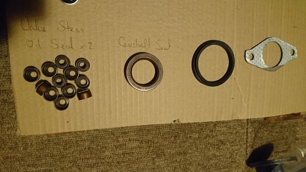

Hello, I am in the process of replacing my cylinder head and need help identifying, some gaskets that came with my Head Gasket set. I have a manual and have been looking at lush projects, but I am still confused. I kept all the gaskets and bits I removed, or thought I did. From left to right
1. Valve stem seals. I don't remember removing these, do they need to be replaced.
2. Camshaft seal. Again, I don't remember seeing this when I removed the cylinder head.
3. Black round runber gasket. (where does this go)
4. Silver metal gasket (where does this go)
It is kind of driving me a little mad, as I want to put my cylinder head back on, but I am worried I will miss a seal or gasket, but I don't remember taking the above off
Any help would be appreciated
Thank you

Did you buy a built CH with valves/cam in place, if so forget those valve stem seals as whoever built the head should have installed them as they rebuilt the new head, the cam seal will fit at the front end of the cam yours might have fell out when you lifted the head or could still be attached to the old head, check it, the silver seal could be for the turbo and I haven't a clue for the rubber ring as I've not had the pleasure of doing a head change on a bongo though I did my hilux which had a rubber plug at the rear end of the cam, it could be this engines variation of that.

Hi Hazzobngo, thank you for your reply. That makes sense regarding the stem seals. I took my CH off to be tested and skimmed. At least I know I can skip those.
I will check the front end of the cam tomorrow for that seal, and the rear.
The silver and rubber seals are still a mystery. Definitely not the turbo, as I have that one.

The gasket on the right looks like either the EGR pipe gasket or the seal for the little oil filler cap housing.
