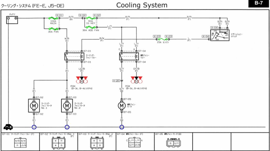

Does anyone have a wiring diagram relating to the radiator fan/ECU please?

I've dug both out take your pick! In both cases the relays are controlled by the ECU, in the case of the diesel, you'll note that they are dual speed fans, so don't go round trying to re-wire them as you will likely cause serious problems resulting in a burn-out of the windings!
WL-T - diesel
Petrol engines

From the wiring diagram you kindly sent, it appears to me that the connection marked with a 15 switches a 12v to both fans via relay B6-01 and a 0v to both fans via relay B6-03. I think this is low speed?
Terminal 16 appears to switch in 12v to both fans- high speed?
Please correct me if I have read this wrong, but I think what I need to do going forward is remove B6-01, by-pass the switching pair of contacts on B6-03 and only use B6-02 to switch the fans on when required?

B6-03 is used in conjunction with B6-01 for one speed and B6-02 is used for the remaining speed mode.
However I can't say if both sets of relays need to operate or alternate sets.
What I can't be sure of (I don't have a diesel to play/test with!) is which mode the motors are run in, dual wound motors can be wound in a variety of ways and connecting them incorrectly can be disastrous, but I have no information on which mode is used.
I would suggest you monitor the relay coils and see what the ECU uses for the speeds simply put a meter on the coil connections going to the relays diagram points 15 & 16 and see which relay sets operates at which speed, bear in mind that the Air Con also turns on the low speed mode when the Air Con is in use at all times.
When monitoring points 15/16 the voltage will fall from 12v to 0v when the relay operates.

1- Why isn't the 0v connection on the fans common?
2- Why does relay B6-03 switch a 0v connection into play?
I can only assume that for high power fan working all 3 relays need to be energised unless relays B6-01 and 03 drop out at full fan and the 0v connection for high power is the ground connection marked as 2 from both fans. If that is the case then I just need to apply the EWP 0v connection to the coil of B6-02 to make the fans run at high speed. I could try this and if they burn out buy a set of fans from a petrol.
Am I correct in thinking that the best way to invoke full fan working is to remove the wires on the temperature sensor on the head? this makes the ECU trigger full fan I have read. I cant test low fan working as my air con has never worked.
It might be safer to just get a 2 pole relay applying a 0v connection to connections 15+16 as marked from the ECU, the relay being triggered from the EWP.
Does this sound sensible to you Sir?
The other option available would be to use the EWP fan connection 0v to trigger a relay that shorts the wires to the temperature sensor on the head and fool the ECU into thinking the engine is very hot. I'm not a fan of this approach as the ECU may use this sensor for other purposes and this could have a number of knock-on consequences.

I have been reading an earlier post by jimmo62. There's something about it which has confused me. Relay B6-02 has a 40A fuse in series. Logically you would assume that low speed fans would be off the 30A fuse?
Can you shed any light on this please?
Re: Does anyone know how the fans on an auto diesel work?
Post by jimmo62 » Sun Aug 10, 2014 3:34 pm
That seems right and agrees with my tests.
The potentiometer burned out pretty quickly (it was only a low power one....) so I had to use fixed resistors.
With a 330 ohm resistor in place of the temperature sensor and a/c off, none of the relays/fans are on. With the a/c on, relay B6-02 is activated. So that corresponds to low running temp - fan is only on for the a/c. 330 ohms corresponds to water temp around 80C (spec says between 290 ohms and 340 ohms at 80C).
With 150 ohms and a/c off, relay B6-02 is activated. That would correspond to high temperature running.
With a short circuit and a/c off, relay B6-02 is activated and so are relays B6-01 and B6-03 for the high fan speed. That would correspond to well over temp.

I have fully tested the voltage readings at the 3 relays when using a variable resistor at the temperature sensor and can confirm that Jimmo was absolutely correct.
I am very grateful for your help and assistance with this query, without it I may have smoked the fan motors!
