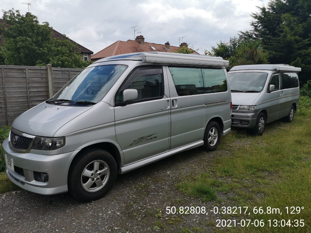

See this picture older style with lower roof behind and the newer Aero style in front.
The newer version has the dark moon window at the front top of the AFT.
