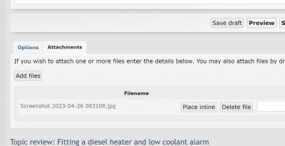

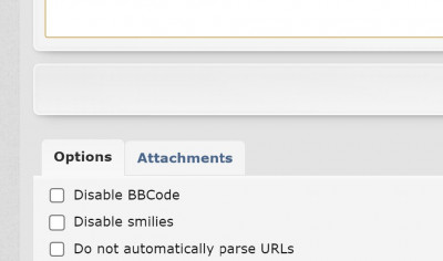

To add a picture;
Open a reply, below the input area
Click "Attachments", Click "Add files" from your machine/network, click "Place inline" the code will appear in the input area.
Click Preview and you can see what the post looks like before continuing the text or more pictures.

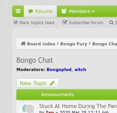

To start a new post, go to the relevant forum;
Click "New topic" and fill in the heading, then fill in the text area with text and whatever else is needed.
