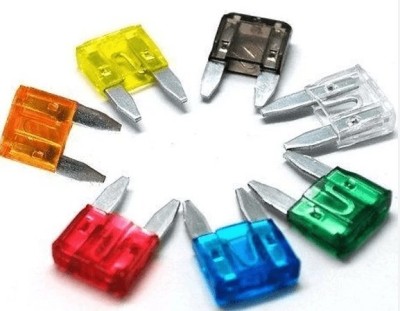

My Starter and Leisure batteries look to have different fuse types fitted.
Starter (100W I think) looks like this: Leisure looks like this (40W fitted):

Re: Should my fridge work this way?
The fuses you show look like the normal vehicle fuses, the two used for feeding the relay will have been added normally in-line fuses in there own holders close to the batteries where the wires feeding the relay are terminated.
