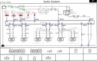

That sounds like the backup supply is not present at all, that supply is fed directly from the battery not via the ignition switch, its the only the main power that is fed via the ignition switch. The two power feeds are at the top right as you can see one is direct to the battery and the other via the ignition switch.

That is correct if you left the ACC powered up the then the switching spikes from the starter motor stand a good chance of doing damage to any electronics which are not specifically designed. The very low current backup supply, the ECU all have additional spike protection, most other circuits are also disconnected during cranking of the starter motor for the same reason.
However the Radio should only just be turned off, not re-booted where you loose the memory settings etc. which is why is sounds like the backup supply isn't connected, loosing the backup supply is what causes a re-boot as opposed to a simple turn off.
