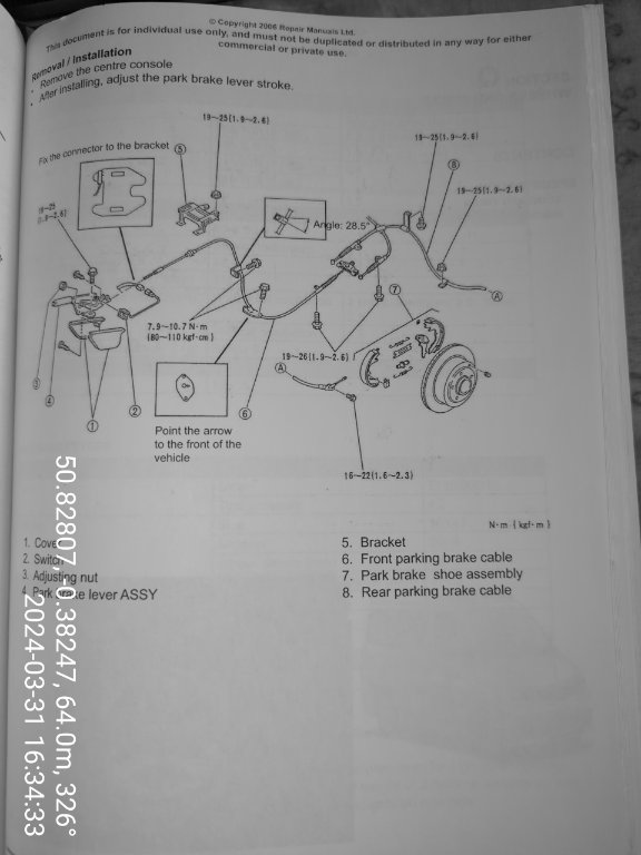

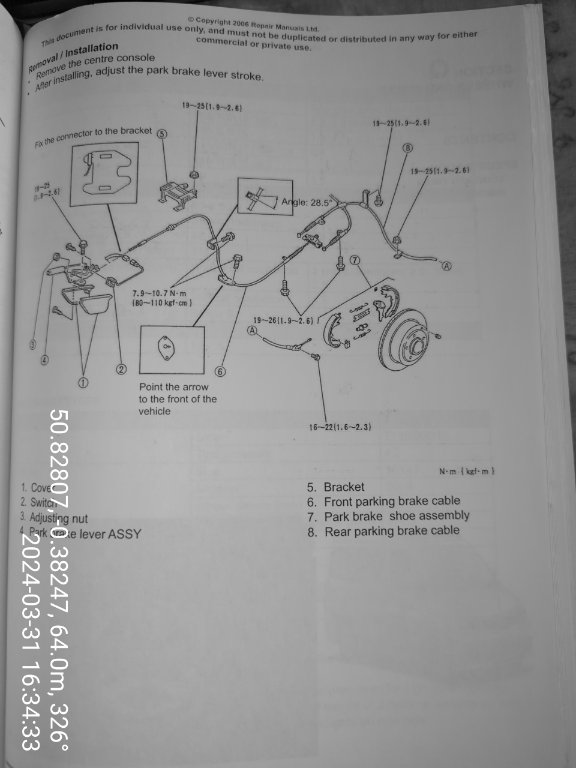

If your going to be doing a lot of your own maintenance work then its probably best to get the service manuals for your engine from the shop, there are 5 pages dedicated to the handbrake system alone with plenty of pictures and descriptions!

g8dhe wrote: Sat Mar 30, 2024 9:10 pm If your going to be doing a lot of your own maintenance work then its probably best to get the service manuals for your engine from the shop, there are 5 pages dedicated to the handbrake system alone with plenty of pictures and descriptions!
But Never anything online? Lol anyway where is this cable splitter that is show in the above images? I can't seem to find anything under my bongo, the only cable that sticks out from underneath is the Clutch cable...... I have MOT Tuesday or Wednesday!

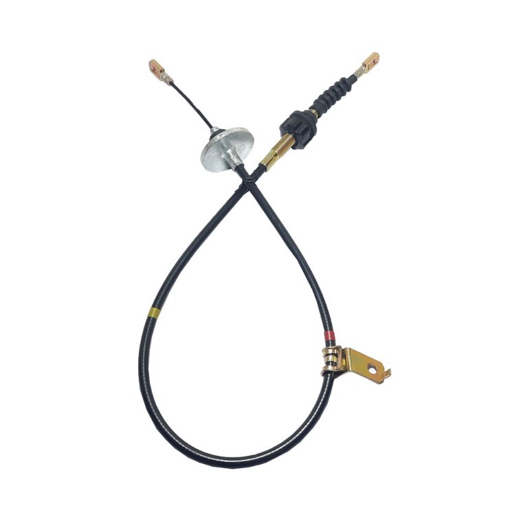

The splitter

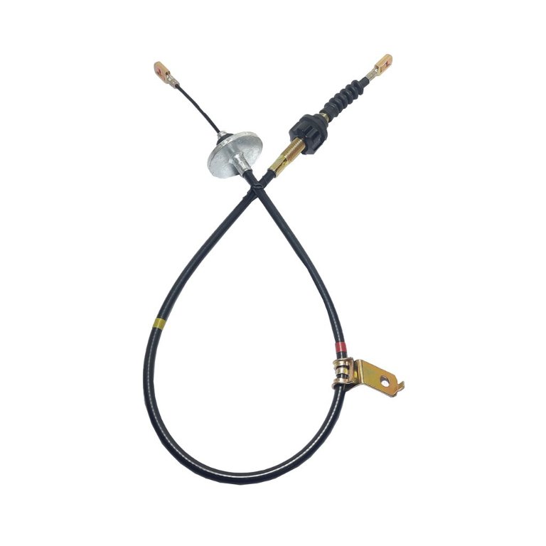

So basically I need to look on or towards the rear axel. Yes mine is an automatic, but when I look underneath, there is a long thick cable that runs to just past the.middle section with a rubber boot gaiter on connected to a small pulley lever. I can't attach.pics here I don't think, if I find a way il attatch one here......
Ah found it. There's a cable under my van that looks like this and the small lever switch seems to be attached to a tank of some sort. It's rainy hard Rn but when it cools down a bit il try and get a fresh pic of it. My9t has been changed till Thursday afternoon at 1300 so now have extra time to order a few bits on next day delivery if I need them.....

There is a cable to the gearbox which ensures that the Parking lock functions and the selector isn't moved incorrectly.

Ok thanks. Thisay be a silly question but is the Handbreak connected to the front or the rear wheels? There really isn't anything online to help me, and I don't honestly understand those split diagrams. They don't help me at all. I like to see the image with simple arrows or coloured lines!
