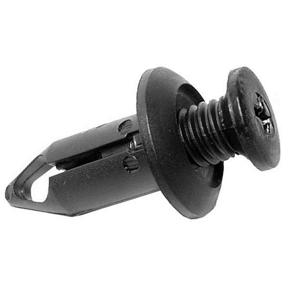

Looking at the bottom section it appears that there are a number of screws holding the bottom of the tent to the roof of the van, are these simply a repeat of the solution used on the top of the tent, overcoming the screws and anti shake compound?
Read that there are rivets I'll need to remove to free the bottom of the tent from the roof of the van, is that correct?

The lower fixings are SCRIVITS - Screw Rivets - lots of them are used in all vehicles, they have a thread for undoing them, but the thread is built into a plastic spring mechanism such that to install you merely press the cap down it expands the springing section and then it locks onto the threaded element when its fully inserted, ready for removal.
