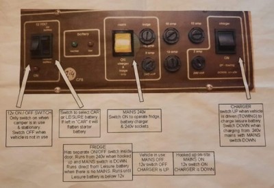

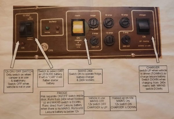

I have also attached a picture of some instructions I got when I bought the campervan (presumably they originally came from JAL imports)
I don't know anything about electrics I'm afraid but I did measure the voltage on the leisure and starter batteries, then I left the mains switch on and the fridge on for a day. After a day the leisure battery had not changed but the starter battery had gone down from 11.95v to 11.58v. So does that sound like it may be connected directly to the starter battery? Also the manual for the zig says this:
"2. The 12 volt part of the fridge is connected to the car via the C.F.9. Note that if it is
switched on when the engine is not running, there is a risk of flattening the battery. "
However the instructions (attached) say:
"Runs from 240v when hooked up and MAINS switch is DOWN. Runs direct from leisure battery when there is no MAINS. Runs until leisure battery is below 12v"

That sounds about right;
The leisure battery links direct to the charger, and all the 12v feeds to your devices will take power either direct from the battery if there is no charging going on, or from the charger if the charger is on, the charger will charge the battery and/or supply the devices as needed.

In case anyone else has the same problem, the problem turned out to be a blown fuse on a lead near a terminal on the leisure battery.
Now it all seems to be working as described on the instructions sheet and the fridge does not turn off when I turn charging on.
