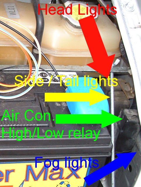

Sounds like the headlight relay is either welded in the operated position or something is causing it be operated all the time. The relay is on the nearside wheel arch rear most relay;

g8dhe wrote: Sat Aug 24, 2024 3:14 pm Sounds like the headlight relay is either welded in the operated position or something is causing it be operated all the time. The relay is on the nearside wheel arch rear most relay;
Thx the picture is helpful and matches what we have. The problem first occurred after heavy rain, so not sure if that's related. Next question is do you have to remove the leisure battery in order to access the relays? I assume so... :?

Possibly, depends on size of LB!! You may be able to reach down under the rubber covers, and then release the plug from the base of the relay, it has a plastic press clip to release the catch. That will then disable the headlights for certain without removing the relay from the holder itself, but maybe fiddly to reconnect if you need to travel with the lights on again!
