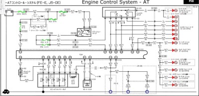

You need to refer to the electrical diagrams which require use of Flash at http://www.g8dhe.net/bwm/ see the discussion on the wiring diagrams on this forum for details of browsers that still support Flash ( https://igmaynard.co.uk/bongo/forum/vie ... 68#p723668 ). There is also the gearbox manual available http://www.g8dhe.net/bongo_images/Gearbox/RC4AEL.pdf
A small image of the relevant page below;

Hi.
Is that gearbox PDF manual for my vehicle? That looks like a later model 'box...
The PDF manual refers to shift solenoids A/B/C/F but the wiring diagram snip you kindly posted only has shift solenoids A/B.
I'm very confused..

The diagram shows a total of 5 solenoids A/B/D/F & TCC, never needed to assign each of the there functions see page 05-13Y-3 where it refers to ABDF&TCC and then the table on the next page where it refers to A/B/C/F&TCC

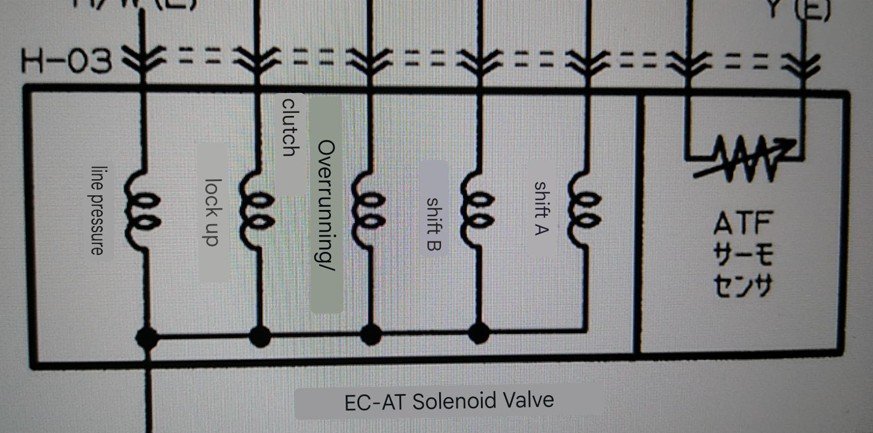

In the diagram I can only find a lot of Japanese-labelled solenoids, only two of which translate to shift solenoids (A and B). The other solenoids (Overrun/Lock-up/Line Pressure) are not referenced in the PDF (RC4AEL.pdf)g8dhe wrote: Fri Feb 07, 2025 11:52 pm The diagram shows a total of 5 solenoids A/B/D/F & TCC, never needed to assign each of the there functions see page 05-13Y-3 where it refers to ABDF&TCC and then the table on the next page where it refers to A/B/C/F&TCC
Is RC4AEL.pdf for my vehicle? It seems to be a newer gearbox than my camper... or does it work the same way?

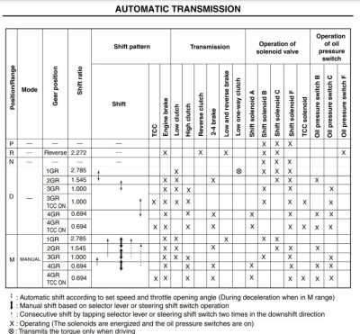

See the table on 5-13Y-4 which shows which solenoids are operated for each gear selection, its not a simple one wire one gear mechanism, its a binary selection from the control solenoids and the internal pressure switches;

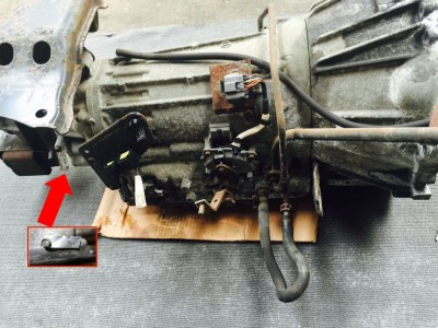

I don't know what gear box it is, sorry. Are there several for mine, do you think, based on the following:g8dhe wrote: Sat Feb 08, 2025 11:06 am Which gearbox do you have on your vehicle ?
Friendee 2.5 V6 diesel auto 1998 (S Reg)

I'm Confused ? the V6 is a petrol engine not a diesel ? The diesel is a 4 cylinder engine not a V6!
Try looking on the gearbox itself, it has a tag with the serial number on, the precise gearbox varies a lot with each engine as the speed ranges vary the RC4A-EL is the generic box description.

Sorry, I must be mistaken... It mustn't be V6.g8dhe wrote: Sat Feb 08, 2025 12:15 pm I'm Confused ? the V6 is a petrol engine not a diesel ? The diesel is a 4 cylinder engine not a V6!
I'm not able to get to the gearbox tag any time soon...
What I don't understand is how the wiring diagram snip you posted (Japanese) only shows 2 shift solenoids (A and B) but the PDF has C/D and F!
How come the wiring diagram doesn't show C/D and F?
Also, why does the PDF call it C on one page and D on another, is that a typo on one page, do you think?

The translations and naming's seem to vary a lot depends I suspect on the sources of information if you look up in the gearbox manual you will see that a lot of the selections is on the basis of the two main gear choices and then the various epicyclic combinations give the other gear ratios.
