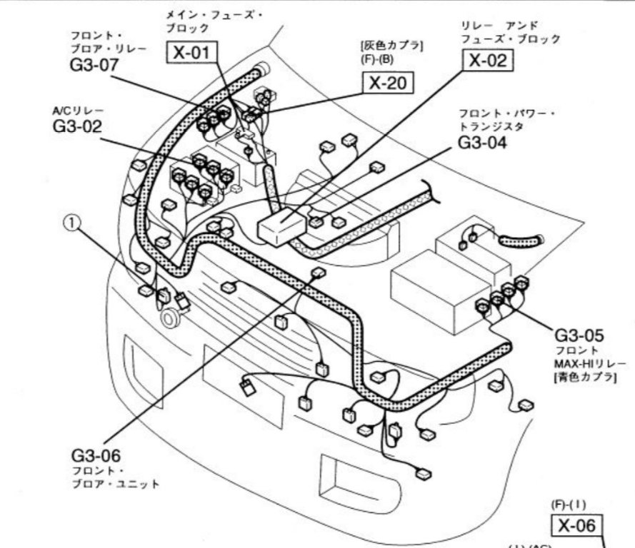

Posts: 10917
Re: Aircon does not run cold on V6
Post by g8dhe » Wed Feb 26, 2025 7:51 pm
Yup there are relays situated on both wings and down underneath the starter battery in this case the one marked G3-02 sounds like it has had the wiring pulled or the relay itself disturbed;
