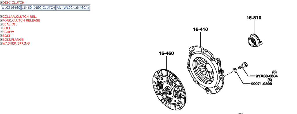

According to the part numbers from the worskhop diagrams for the clutch I am seeing:
the part number for the
release bearing G56116510
clutch plate WL0216460
clutch plate cover: WL0116410 / WL0216410
I have seen a kit which details:
but the part number for the clutch plate is WLA2-16-460F S2 and not WL0216460
A long shot, but has anyone had to change a clutch on their rare manual bongo or know the significance of the WL02 and WLA2 part numbers please?

Can you remember what borg and Beck part number you used? My garage seems to think it is a HK2545 ; but that states for use with dual mass engines.
I thought it should be a HK2094
The conflicting information makes me unsure :-/
Going by the mazda prt number for a up 1997: https://www.autodoc.co.uk/car-parts/oem/wl0216460
The ADL Blueprint part number for just the disk is ADM53149 for:
Manufacturer/Model/Type/KW/Manuf. year (from - to)
MAZDA
MAZDA MPV I (LV) ( 05.1996 - 09.1999 , 115 PS)
MAZDA E-Series III MPV (SG) ( 06.1995 - 09.1999 , 125 PS)
But I cant find that in a kit with the cover and bearing
