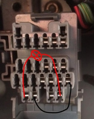

Yes. I have had this problem previously when trying to find an ABS fault...When I first got the bongo it had an ABS light on, but everything I read online told me to connect the jumper wire and LED to pins that don't exist in my diagnostic port. I put a post up on one of the facebook pages and somebody gave me completely different instructions that I've not seen anywhere else. I had to put a jumper wire from TBS to GND, then count the flashes on the dashboard which ended up working perfectly for me. But that's specifically for the ABS system and doesn't help me in this situation. I now need to know how to read engine faults, but I'm back in the same situation with everything I read online telling me to connect to pins that I don't have in my diagnostic port.
This is a generic image that I found online, but my diagnostic port looks like this. TEN should be the second one in from the left, bottom row. FEN should be the fourth one in from the left, bottom row. But as you can see, those pins aren't there.
