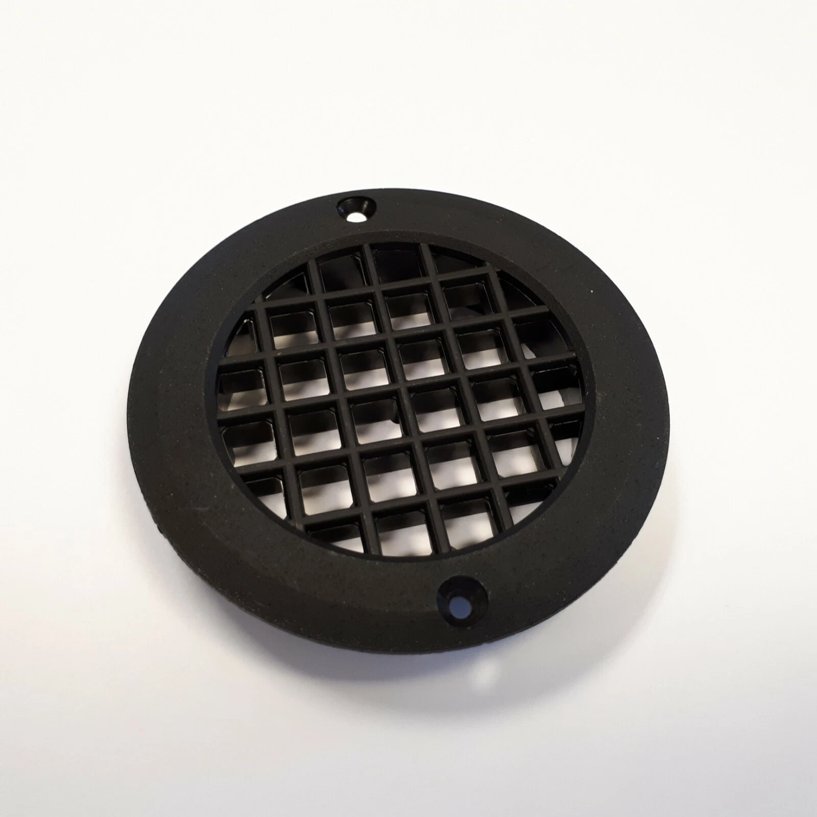

Where ever you end up putting the gas locker inside you need to install a drop-out vent, the gas being heavier sinks to the bottom and drops out of the vent to outside. See https://www.google.co.uk/search?num=100 ... p+out+vent

g8dhe wrote: Sun Jul 20, 2025 10:07 pm Where ever you end up putting the gas locker inside you need to install a drop-out vent, the gas being heavier sinks to the bottom and drops out of the vent to outside. See https://www.google.co.uk/search?num=100 ... p+out+vent
I had to do that on a previous camper which had a gas locker, but ideally I didn't want to drill a hole in the floor of the Bongo if I can avoid it...Hence why I was wondering if I could safely transport the bottle with the regulator off and not hooked up to anything, without a gas locker/drop vent. Then I can hook it up outside when I want to use it. Or does it need to be in a gas locker with a drop vent no matter what?

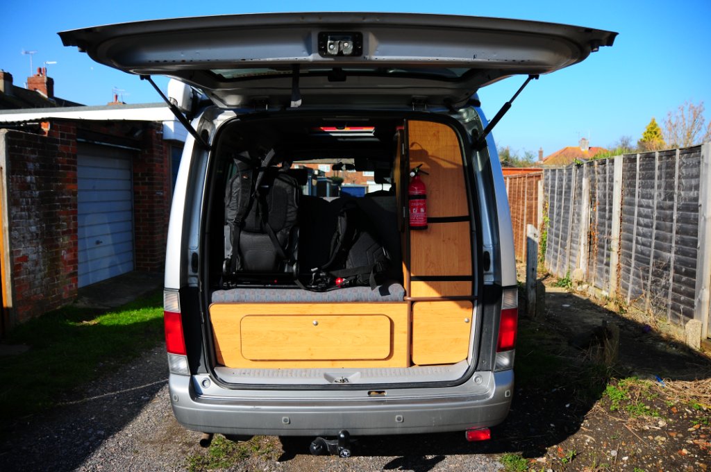

Mine is the simple surface mount style, hole drilled thru flooring and chassis below and then two screws. Mine however is a side conversion with the gas bottle accessed via rear door into the offside side cupboard with its own door.Image

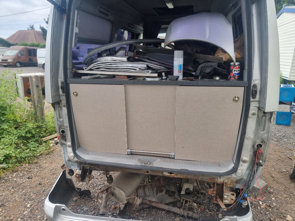

g8dhe wrote: Mon Jul 21, 2025 10:41 am Mine is the simple surface mount style, hole drilled thru flooring and chassis below and then two screws. Mine however is a side conversion with the gas bottle accessed via rear door into the offside side cupboard with its own door.Image
This is the only picture I could find from when I was doing some rust repairs. The only space for my gas bottle is in the offside cupboard. But inside that cupboard all of the electronics (electric hook up, solar charger, etc) are mounted on the right hand side. So the gas bottle would have to go on the left hand side, closer to the centre of the van.
In the near side cupboard there is 2 small tanks for fresh and waste water, then in the centre there is space for a fridge (can only access it from inside the van). So there isn't anywhere else for me to store the gas bottle.
