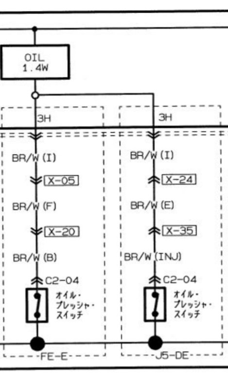

The dashboard light is merely an Oil Pressure light to indicate that there is a problem, it controls nothing else other than the light;
However its worrying that you could fit 3.5l of oil in that would tend to indicate that you had lost a lot as the total is 4.5l in the specifications!

Ah thanks Geoff. Sounds much more likely the Oil warning is just the effect of the engine cut-out then, not the cause.
