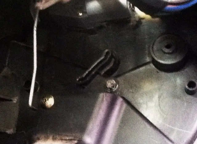

Check that the passenger side one is actually turning the shaft into the air box itself, I've seen ones where the shaft itself had broken before it entered the air box.

Yes drop out the glovebox, then worm up and under, cover as I recall is one maybe two screws then you can see if its actually rotating the spindle;
picture attached shows the one that snapped off!

Thanks Geoff. All seems fine, just not very hot. The car needs a coolant change, so perhaps a flush of the heater matrix is in order.
