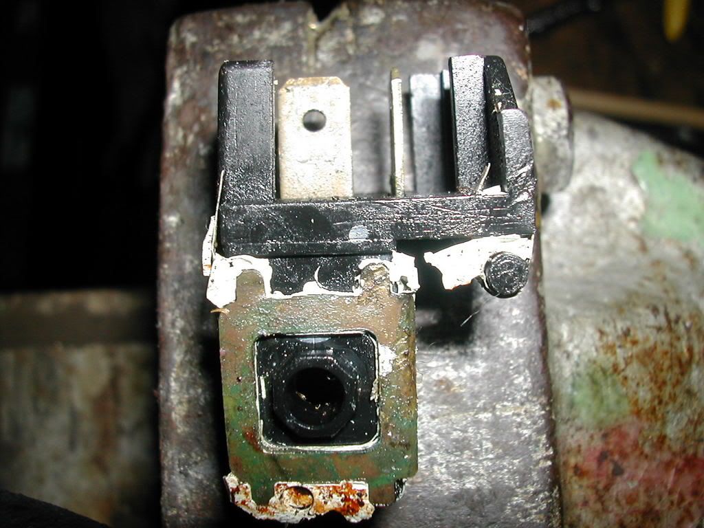

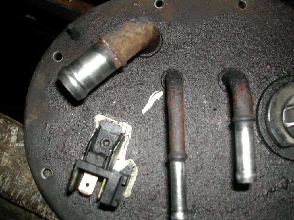

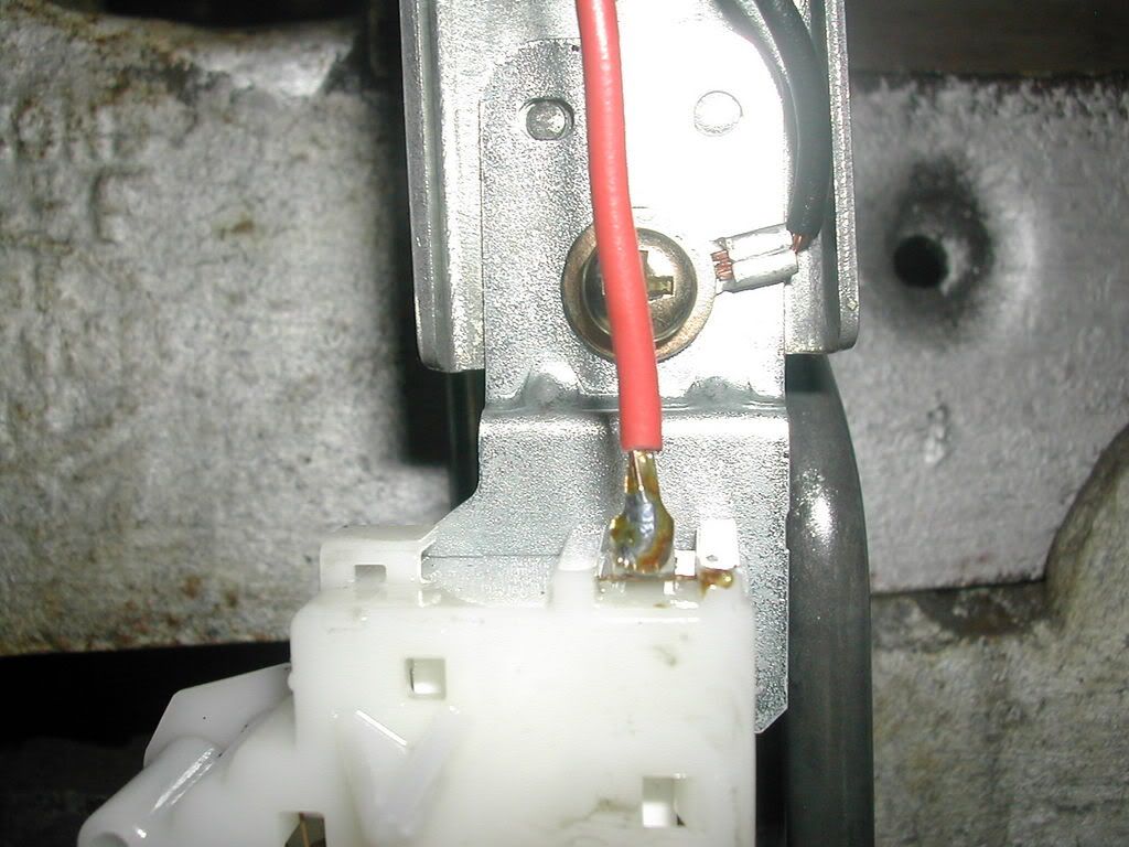

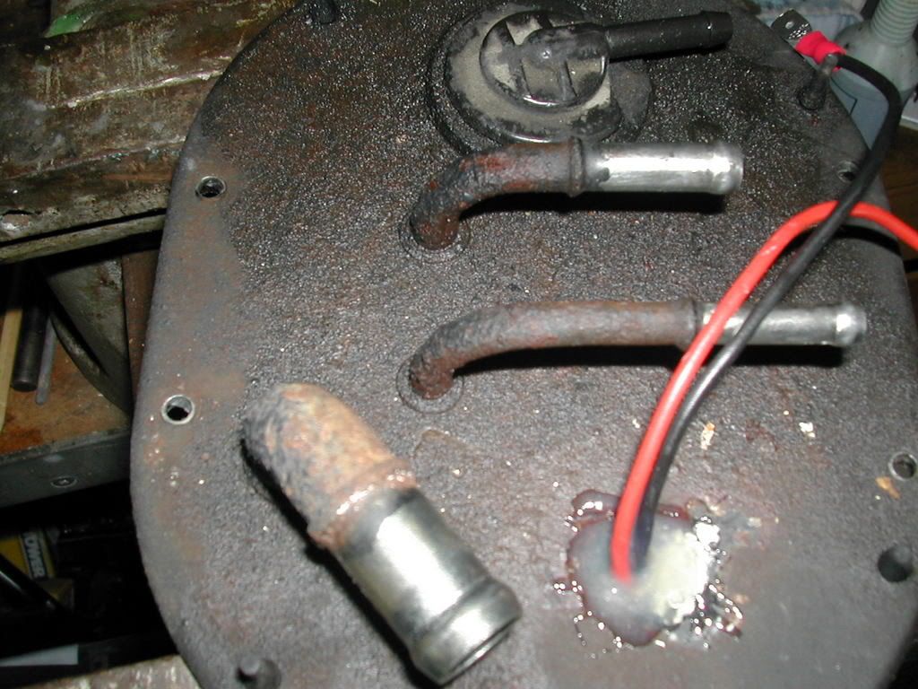

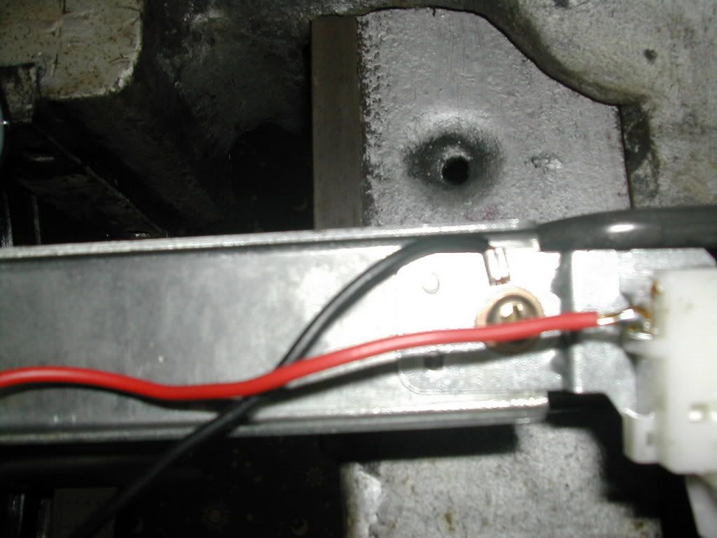

Bollicky
pics
Post by Bollicky » Mon Apr 16, 2007 9:04 pm
from this Image
to this
like this
the root of the problem
hows that for ya all?
