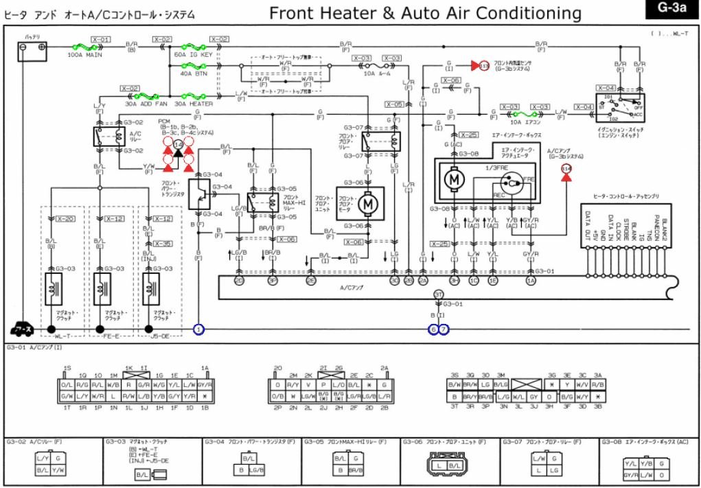

Hi, are the manuals still available to download from anywhere? I couldn't see any links on page 1 of this thread.
I've got an electrical issue with my fan speeds. My mechanic tells me the connection isn't grounded, so I thought I'd try and find some info on it.
I've got a 97 2.5 TD

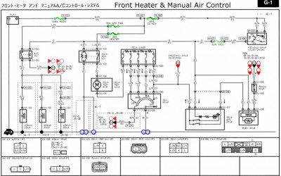

I believe Ian is still selling the PDF documents. my web site is no longer directly available with the demise of Flash. I can however still paste copies up here of the relevant pages not sure which type of controller you have as there are two types the Climate Control electronic style or the older slider style;

Oh sorry yes, mine is the electronic style.
Can I presume that's the first image?

Yes its the first diagram above for the electronic version.

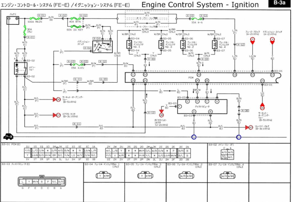

I'm looking for the ECU harness pin out or if that's not available the pin out for the 2L distributor wiring (2003). Is this available anywhere please?

The diagrams on the Web never went upto 2003 however I think Ian has PDF's for 2003 versions ? The older distributor wiring is shown below;

That's great, thanks. I'm after the pins for the cam and crank position sensor outputs to start with. I'm pretty sure I've identified them using an oscilloscope, but would like to confirm. Looks like we have a match :)

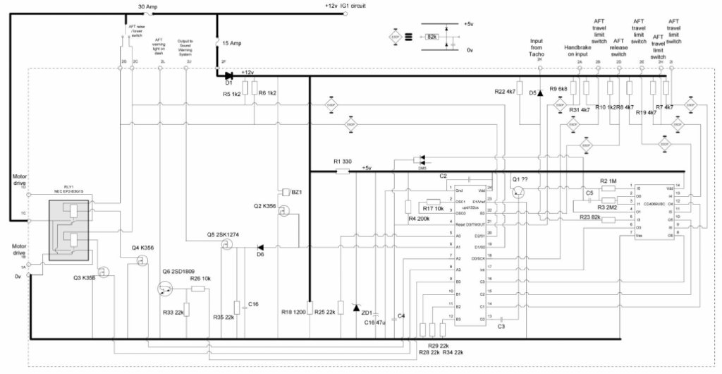

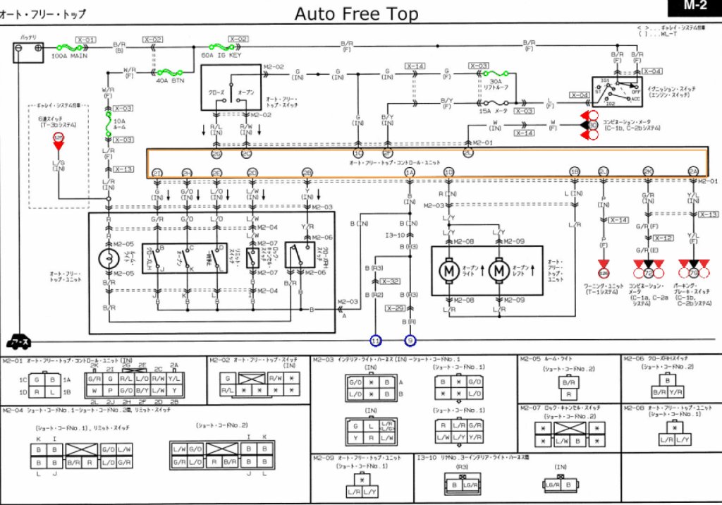

I've got a 88 VW T3 with Mazda Bongo electric pop top Roof project. I don't have wiring loom so I have to make it.
Mabe someone could help me with some electric roof wiring digrams?
Posts: 10966
Re: Bongo Wiring Manuals
Post by g8dhe » Wed Nov 30, 2022 9:45 am

Would it be possible to get a better quality of picture AFT-1? The letters ar so blured...

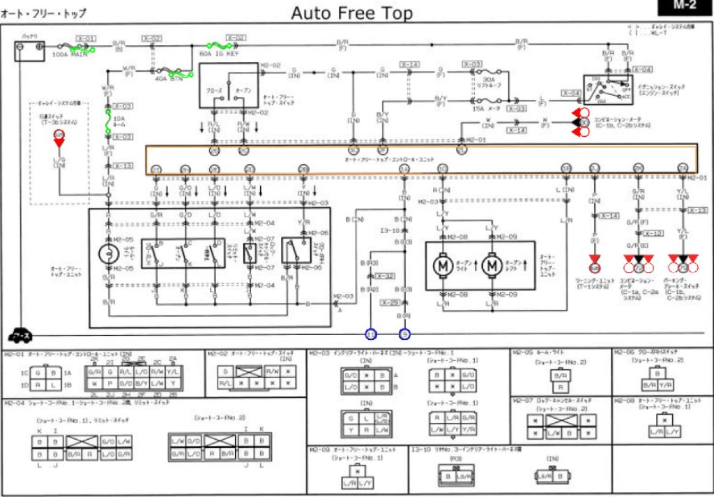

These might be slightly higher resolution, but as you don't have Flash available then they can only be screen grabs;
