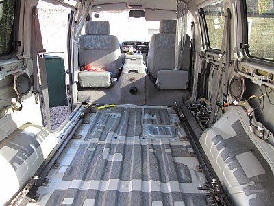

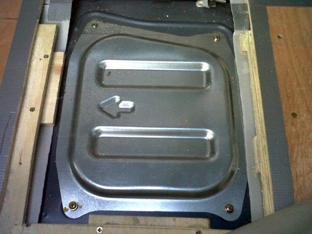

I need to get into the fuel tank being it has been standing for so long and see if it is not full of cr* p do i have to remove the the floor rails to get to the sender i did a search on the forum but not that clear cheers again
Posts: 10937
Re: new member
Post by g8dhe » Tue Feb 16, 2021 4:20 pm
Not certain, not heard of anyone saying they couldn't reach it ?

Well i have removed tank sender unit and the tank is clean and there was diesel in there to make sure it wasn't anything to do with the running issues before i road test.
I know the fuel gauge does not work i have put a direct 12v feed to the plug and a good earth still gauge not working .
Put a meter on the sender moved the float up and down and got a fluctuating reading so i am hopeing that the sender is ok i checked every fuse and all ok .
Not that important i know with the other stuff i have to do brakes / steering check ect #-o but with my running issues thought i would ask about fuel gauge
