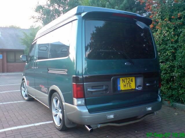

Reversing the other night and could not see a thing out of the back window
   Does anyone know if the lamp can be replaced by LED's, if so what fittings are they? Or from searching on here, I have see someone added lights on the bumper would this be a better idea? I already have the single fog in the rear bumber.

Try http://www.ultraleds.co.uk they may have what you're after. If you need bright look out for ones that use high power leds(1W and above) e.g. Luxeon stars or similar. They're fairly easy to spot since they usually have a heat sink built into the body. The obvious dowside is that they run very hot.
Flush fit reversing lamp to match the fog ( uses same housing but with a clear lense - fits to LHS of bumper) from Far East Services £10 plus post plus the dreaded VAT

Do you think this would look ok? (mounted horizontal)
http://www.deltadesign.co.uk/products/c ... leled.html
Scroll down to reversing LED.
Seems a bit overkill compared to £14 for a flush fit reversing lamp - but - - they look great  -  surely cost an arm and a leg though !
Doesn't say how they are mounted -are they flush fit? Is there space behind the bumper ? - probably yes . The 'rib' running along the middle of the bumper is 80mm - they would just overlap this by 3 or 4 mm top and bottom - how would this going to affect a neat flush fit /seal?

I had the same problem as you with regards to rearward visibility.
I adapted mikeonb4c's concept of flush fitting fogs, to flush fitting clears, I just remove the clear bulbs at m.o.t. time, and replace with red bulbs.
So i have the option of 4 reverse lights when the need arises

Simple MG,...The switch and wiring remain unaltered, the factory fit reverse lights illuminate as reverse is engaged,then i click the "foglight" switch if extra illumination is neccessary.
I make sure i always carry the red bulbs in the glovebox, just in case of a sudden "peasouper" but, i have been lucky so far, as i've only needed to swap over the bulbs for the m.o.t.
