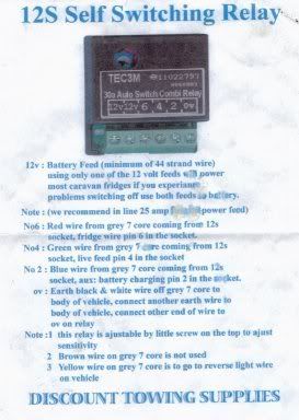

I have got myself a Voltage sensing relay TEC3M to setup a split charge relay. It has 6 inputs on it labelled as follows:
12v , 12v , 6 , 4 , 2 , 0v
Now presumably I wire up 1st one to the postive starter battery terminal and the 6th one labelled 0v to earth.
Do I then wire the 2nd 12v one to the leisure battery. What do the 6,4,2 inputs do?

I bought one of these to run my 100A Split Charge Relay. I wasn't impressed as the "adjuster" screw and contacts fell apart recently after only a few months so I dumped it. I should have bought the Willinton one. Have you not kept the instructions that should have come with it? If not I'll try and dig my copy out. IIRC 1 goes to starter battery live, 2 goes to terminal 86 on your SC Relay and 6 goes to earth. I would need to read the instructions to verify though.

How's this:
(Hope you can read that. I had to keep it small in case I got collared by the Image size police)
So I wasn't quite right:
One of the 12v connectors to +ve on starting battery
No 2 to SCR
0v to earth
No 2 to SCR
0v to earth

Thats greats thanks alot
