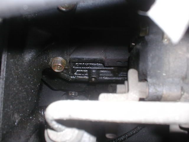

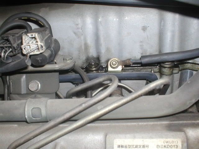

Post by ronhud » Sat Sep 20, 2008 11:21 am
Should I be worried about this level of oil on my engine or is it fairly normal?
Driver side
Passenger side

Post by helen&tony » Sat Sep 20, 2008 11:30 am
It looks pretty normal from what I have heard. Mine is like that, and it loses no oil between services at all. i have blanked off my EGR a while back with one of Allans smashing kits, and it now seems a bit more baked on, so it could be from that source?

Post by mikeonb4c » Sat Sep 20, 2008 12:34 pm
Mine too. When I bought it, some of the oil on the rocker cover (towards the rear, nearside) seemd fresh. So I GENTLY tightened the rocker cover nuts in that area (overtightening could distort the cover thus moving the problem and/or risking cracking it - that's how I saw it anyway). Then I gunked the area. I don't think there's been any fresh oil since.
The area round the diesel injector always looks oily, but I think that is down in most part to my slight leak on the injector oil seals. Hey ho! 8)

Re: oil on engine
Post by haydn callow » Sun Sep 21, 2008 7:45 pm
Think you will find most of it comes from the EGR and in fact not the oil system.

Re: oil on engine
Post by bigdaddycain » Mon Sep 22, 2008 10:31 am
My reply reads much the same as helen&tony's... The oil looked fresh for years,blanked the E.G.R,then the oil dried up. All was still clear the last time i looked. :wink:
