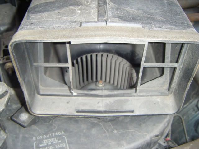

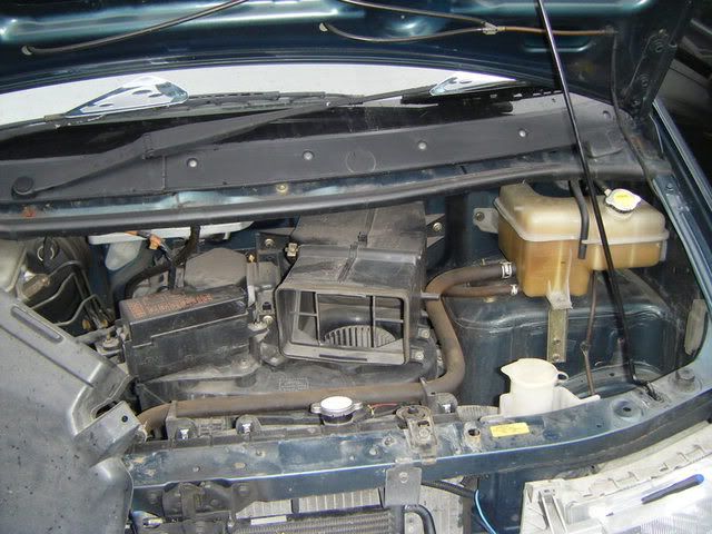

heater fan
Location of heater fan

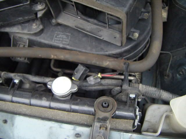

While I was under the bonnet I noticed this connector.
If disconnected the heater fan does not work but the fans that come with for the aircon do.
now if you switch the aircon on the main radiator fan starts and that may be what you think is the Aircon fan.
if the heater fan is no siezed then maybe try disconnecting this connector and see if any electric is gettin that far, if yes then look at fan motor if no then work back.
Ameture advice I'm afraid but thats all I have

That's great Rob. The reason I could'nt see the fan on mine was there's a flap that was covering the access. Will continue now with trying to solve the problem. Thanks for your time. I owe you a beer.westonwarrior wrote:heater fan

yes forgot to say if you have the heater on recirculating it covers the fan with a flap.
