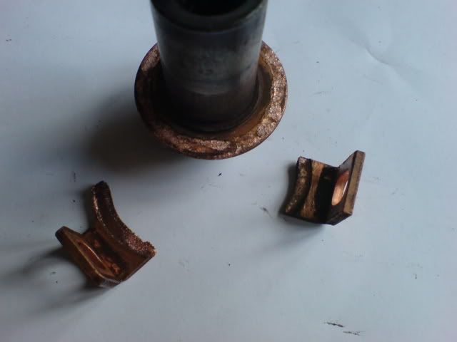

I got the contacts & plunger orderded from Auto electrical Supplies Southampton - 023 80211988 as found in the compatible parts database, & kept my fingers crossed, it's played up a few times while I waited for the bits to arrive - which they did this morning. Half an hour later, bongo wouldn't start no matter what
45 minutes later - job done & on my way
Here's why it wouldn't start
not a lot left
If anyone is having starter problems & knows the difference between a spanner & a screwdriver - get on & do it youself - it is DEAD easy, it was about £20 for the bits & I reckon just about anyone could do it
