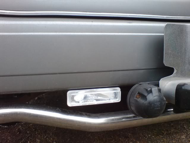

In true Blue Peter fashion, here's one I made earlierkeefysher wrote:I've got a pair of the small driving/fog white lights off Simon Jones to fit on the rear somewhere, once I've fitted the rear nudge bar.

Re: Reversing lights on facelift Model
Trick photography
. It is actually the same light in two locations to check it fits. Not quite got round to wiring up yet, but will probably use a relay run from existing reversing light & then I've already got a 12v feed from the main battery which runs to the side panel by the rear conversion.
There seems to be some debate on whether reversing lights are part of the MOT test or not. Some websites say they are not, others say if they are fitted they should work. I couldn't see anything that says having more than two was an issue, so you should fail by fitting extras. If you fitted a manual switch, then it would probably need a warning light to show on the switch to remind you that they are on.

They're Sparkrite 'Super H3 Hyper Fog' lamps which use 55W bulbs, so are pretty bright:
I bought quite a few sets when I found out that they were a good fit on the Bongo. There are still a couple of them new & boxed sat in my garage which are available for £5 a set + £2.50 P&P. Drop me a pm if you would like any more details.
