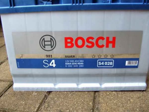

249/335 BOSCH SILVER S4028, CAR BATTERY 95ah, COLD CRANKING AMPS 830 SAE.

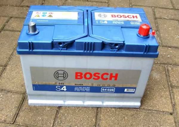

Delivery was next day if you ordered before noon. So very pleased and have now fitted it. Photos below:
Battery tray before fitting
Position of terminals
Battery model etc.
