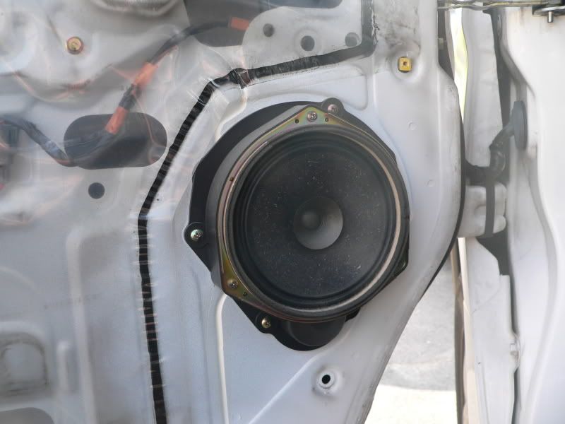

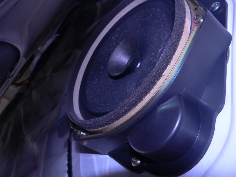

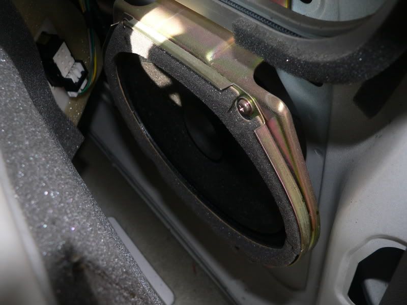

I've have managed to gain access to my speakers here are some pic
http://i86.photobucket.com/albums/k96/p ... 120447.jpg
http://i86.photobucket.com/albums/k96/p ... 120451.jpg
http://i86.photobucket.com/albums/k96/p ... 120452.jpg
http://i86.photobucket.com/albums/k96/p ... 120455.jpg
http://i86.photobucket.com/albums/k96/p ... 120456.jpg
Now the front one sound half descent, but the back one are very quite can anyone confirm from my pictures if the speakers look like the ones, that come standard in bongos or not.
The measurements are, front 6" and rear are 6" x 8"

look like the standard bad boys to me mate, just changed all of mine

are the front ones glued to the doors as well as screwed because i took the screws out, the speakers and they still will not budge.
i tried removing the screws into the door its self then the ones into the plastic outer but no joy

I took the speaker and the mounting pod out together, think you are right they are glued, i had to use a mallet on the magnet of the original speakers to free them from the mounting pod, which was no probs for me because i was replacing them anyways. I put some 16cm alpines in there, used that self adhesive draught excluder around the edge of the mounting pod before screwing the new speakers in to ensure a tight fit.
hope that helps, good luck

i think the rears just unscrew, and the mounting case stays in situ and you just un-plug and lift out the speakers.

Getting at the rear ones is the problem, I have tried but cannot seem to remove the panel, there is no clearance with the seats, managed to get all but one screw out by reaching in with one hand and holding the panel back with the other but had to give up the damn screw would not budge. I am gonna try the front ones soon as the cannot cope with my dvd player.

Hi i have split rear seats and took them out before i removed the whole panel, easy to do just a couple of bolts on each seat and the bottom seat belt bolt then lift out whole seat. you can then get to all the screws and prize off the rear panel, be careful not to break the clips.
