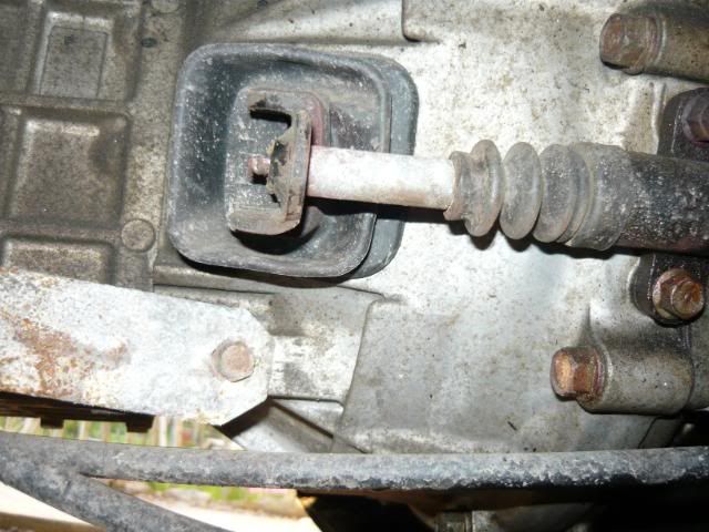

I drove the bongo up on ramps, and had a look underneath. Is there something missing/wrong with the clutch linkage? as seen in photo. The linkage is not joined to the clutch lever. theres just a thin bit it poking through. When driving the bongo up the ramp there was no rattle.
but now the clutch pedal sticks.
When I told the wife she said "Oh, I thought the pedal dropped a bit when it happened."

have u tried selecting gears ureself,the rattle could be from the clutchfork or release bearing although if these are gone it wouldnt just effect 5th gear it would be all gears! the pic looks like the slave cylinder is almost fully extended ,does it move much when the pedal fully depressed?

Not much movement, a few mm's

Possibly not being much help as my bongo is auto, but is that pbit supposed to poke through the release arm?steviebongo wrote:have u tried selecting gears ureself,the rattle could be from the clutchfork or release bearing although if these are gone it wouldnt just effect 5th gear it would be all gears! the pic looks like the slave cylinder is almost fully extended ,does it move much when the pedal fully depressed?
Many years ago i had a problem with a Mk 2 Cortina with a similar arrangement, the piston from the slave cylinder wore through the release arm.
Easy fix, put a thread on the bit poking through and put a nut on it, then grind it into a knob.

Another thing I have just noticed, is when I push the rod back fully, the fork? ( what the rod was poking through) has what I would of thought was a lot of play.
When you then push the rod back as far as it will go and then press the clutch pedal, the pedal sticks, when you pull the pedal back into position, and pump again it starts to work ok. I'm guessing it's to do with the slave cyclinder etc, and thats working ok?
With the engine running, there is a slight rattle from the area of the fork, and when you press the clutch pedal the noise disappears.

sounds like the release bearing has possibly collapsed the fork should move consideribly more than a few mm,i'm afraid the box will have to come oot for further investigation, poss a full clutch kit would sort it best of luck at the garage.
