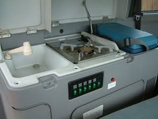

The Mazda unit looks like this
If yours has no battery inside the unit, its a fair bet that one of the batteries has at least been wired up to the sink (as mine is, but mine isn't a lesiure battery set up yet) As far as I know, its generally the passenger side one that gets switched to a LB but only after installing a Split Charge Relay kit.
