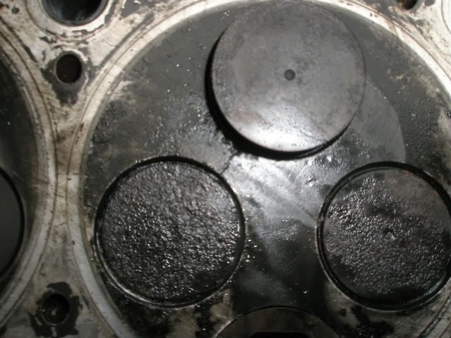

Well after 10 months of intermittent overheating and slight lose of water I now know what the problem is :D crack between inlet and outlet valve in cylinder No.2 I have found this out by taking the head off yesterday.
So any advice on where to get a good head from and anything else you can think of will be greatly accepted.
looking back it only seemed to overheat when under a big load like going up hill or after a hard run the suck in traffic. So i can only think the crack would open up when hot. Also I could bleed the car on the drive for 1 1/2 hours and it would be fine and not over heat until you went for a drive. Oh and I had no white smoke / steam coming out of the exhaust on the drive but couldn't say when driving.

Few pics of the said crack as you can see the valves had started to deteriorate, so probably been going for a while.
said crack
1 3 & 4 look good shame about 2 :lol:
see the white from boiling water from the last time it ran
Keep the Faith

That looks pretty conclusive :roll:

Thanks for the pics Max - v. interesting to see those but sorry about the head. Weird, but in the pics (though it must be an illusion) it looks like the valves are closer together on no.2
If Simon Jones is willing ot keep an eye on you and advise on the all important flatting of the block, and since you are clearly capable of working on an engine (I couldn't do that even if I wanted too - even washing the car todya had caused my back to complain :( ), I'd be v. tempted to get the goods from Ian and DIY it, procvided you can afford the time it may be off the road while you the job carefully (which I suspect is the key to a successful repair, and since you don't have to consider an hourly charge rate, you have a head start)

mikeonb4c wrote:Thanks for the pics Max - v. interesting to see those but sorry about the head. Weird, but in the pics (though it must be an illusion) it looks like the valves are closer together on no.2
Good luck getting the old girl mended. Keep us posted 8)
they do look closer don't they Mike but the outlet valve is open so I think thats it.
Yes have read Simon's threads and have taken note.
