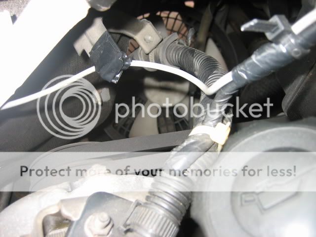

Post by daveblueozzie » Tue Jun 22, 2010 7:53 am
The fans are at the bottom/underneath the engine, it cools the air around the hot engine when the vehicle isnt moving, like franco said, you may only hear it after a long run when you stop .

Post by widdowson2008 » Tue Jun 22, 2010 8:07 am
To see it, you need to lift the engine cover and look toward the front of the engine, low down.

Post by Darkstar » Tue Jun 22, 2010 11:26 am
Ok found it thanks, tested by shorting plug beside h/brake,as per other posts. lets hope sensor works. :D

Post by Northern Bongolow » Tue Jun 22, 2010 7:54 pm
as jaylee says its the black plastic looking probe that is mounted behind the handbrake, facing down to the rocker cover.
