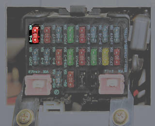

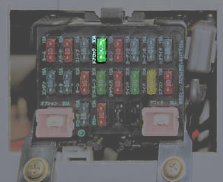

There are two fuses involved;
Above controls the motors
controls the switching.
