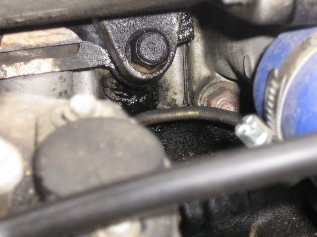

I have an oily stain on the offside front of the block, and i have to clean it off soon, and i'm a little curious as to its origin....The fact that it does 5-6 thousand kilometers to a pint of oil indicates it's not oil, and it appears to come from the bottom of the front inlet port on the manifold, and a lesser one at the rear inlet port leads me to think it's a small diesel leak, but no indication of smell.
1/. would diesel look like old glazed oil on the block
2/. could it be gunk from when I blanked the EGR a couple of years back oozing out?
Picture here:
http://img.photobucket.com/albums/v381/ ... 001-14.jpg
Any thoughts appreciated

Hopefully, that is just EGR gunk.
I say hopefully, since that's exactly what mine's like, and I've put it down to EGR gunk. I have blanked it off, both ends, but not got round to cleaning the block.

Egr gunk & I suspect a certain amount of oil coming through from the rocker cover breather which feeds into the air inlet pipe as it comes around the rear of the engine. Just about every diesel bongo has the same oily stain

Yep...EGR gunge....they "all" have it'

The photo looks like there's oil residue under the inlet manifold. The oil from the breather and turbo etc condenses in the intercooler and can cause this to happen... oil vapour... it gets sucked through from time to time and goes into the manifold etc. I guess the manifold gasket wears, you could check the manifold bolts are tight. If you clean the intercooler it should stop for a while, but is likely to come back. I don't think it's due to a fault with the intercooler, it's just one of those things they do... Landrovers, Pajeros etc can get the same thing happening. But I could be wrong.

Thanks folks...I thought it might be as I said in "Thought No. 2"...

the vapour is pulled through the system and burnt by vacuum,if this vacuum fails, ie a leak,the oil/ air flow will stall and condense and gather, imo.
