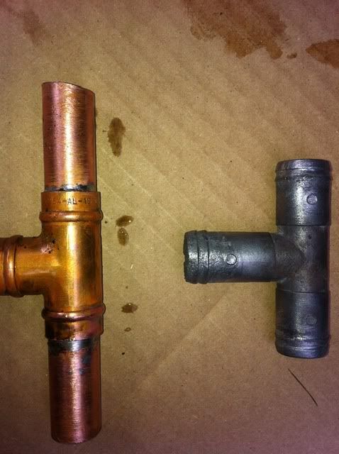

I have noticed a large wet patch on the drive and after examination it seems that its coming from a T-Piece in the cooling system. Its located in line with the trailing edge of the drivers door near the sill edge and links three flexible hoses. I reckon its the usual Mazda problem of using ferrous metals in the cooling as I can hear it crackling when I move it.
Has anyone changed this part or fitted a modified one ? I cant see it mentioned on any of the threads on coolant or diagrams. I was thinking of a copper central heating t-piece instead as it might last longer ??

When I took it all apart, the tee piece was not in such bad shape, but there was enough pitting to suggest that water was getting round it somehow. Anyway it was an excuse to practice my soldering so I made a new one with 15mm tubing and longer lengths to allow for twin jubilee clips. At the moment all seems well. Complete git getting the air locks out though. I cannot for the life of me find the vent tube in the engine bay. Thinking this must be for the diesels only ???
Got there in the end but it belched a few times whilst trying to overheat ! have led to the leak...
A couple of photos if it helps anyone. You can see the pitting that seems to
http://i1143.photobucket.com/albums/n63 ... 54f897.jpg
http://i1143.photobucket.com/albums/n63 ... da9252.jpg
Regards
Tony
