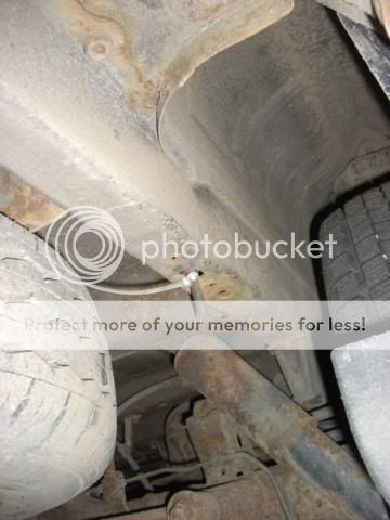

I've not done mine yet, but I'm planning on putting the inlet plug on the offside plate used to mount rear bull bars to. It's nice and near the back of the van for easy access for both fitting and plugging in, but doesn't protrude for parking mishaps. Also there's a nice wee grommet at just the right point to feed the cable through. In the pic below it's where my sink drain was originally fitted.
and from the inside you can see the grommet alongside the rear of the rear offside wheel arch.
