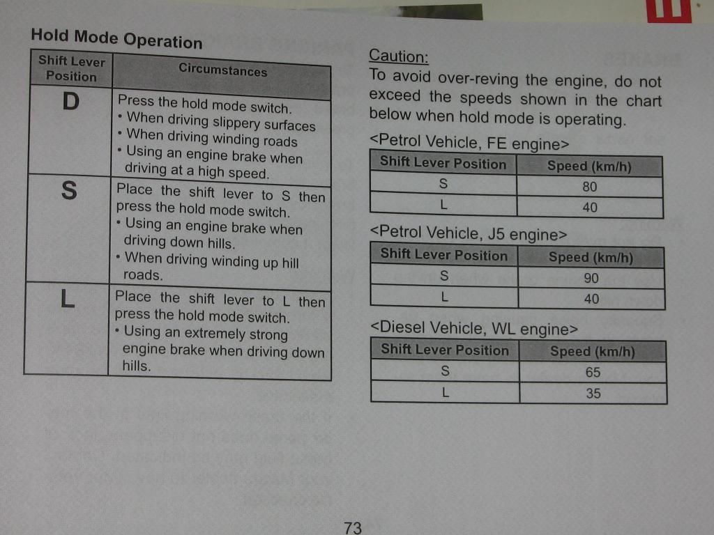

I've still not quite worked out what the HOLD function actually does on mine
Re: Hold function not working!
See the Manual here http://www.igmaynard.co.uk/bongo/forum/ ... 97#p574497
Basically it locks the gear in your selected mode L .. S .. D .. or dependant on road speed drops the box down a gear ..
if you are in 'D' it will drop the box out of 'lock Up' (basically like putting a Five speed manual into fourth .. or disengaging the overdrive in earlier boxes ..
Try it .... if you are in 'D' and say doing 40mph ... look down at the rev counter as you press in the 'HOLD' button the engine revs will increase by around 500rpm ..
Lets the engine rev more freely to save 'slogging' it up hills or using the (fuel consuming) kick down on the accelerator pedal ... better engine braking going down steep hills .. or simply using engine braking in slippery conditions ..
On mine .. putting the HOLD light on a V6 when starting off in 'L' gets the Bongo away sharpish .. the engine freely revs up to 5500 - 6000 rpm before I manually changeinto 'S' .. then into 'D' .. then knocking the HOLD light off .. where it smoothly goes into 'overdrive' ..
