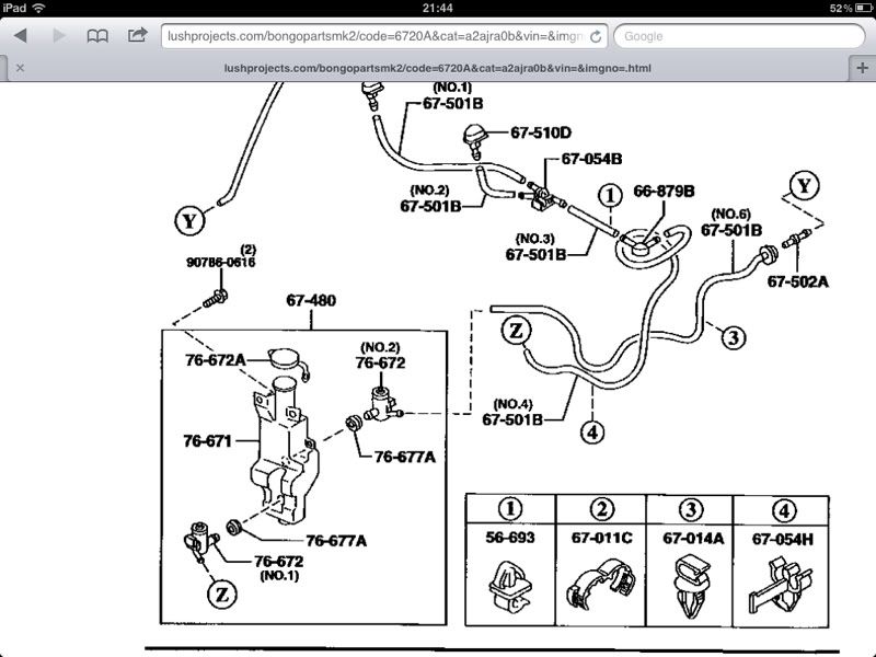

With regard to the pumps being different, I can only comment from my findings which was that one had two parallel spade terminals like this | | while the the other had one at 90 degrees like this -|teenmal wrote:Hi,the rear and front pumps are the same,if not someone has had a go at them in the past.
They also have different part numbers:
S05B67482 76672 PUMP,WASHER ???A NO.1
S05C67482 76672 PUMP,WASHER ???A NO.2
...and if this diagram is correct, the pipes come out at different angles as they are effectively mirror images of each other:
