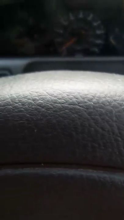

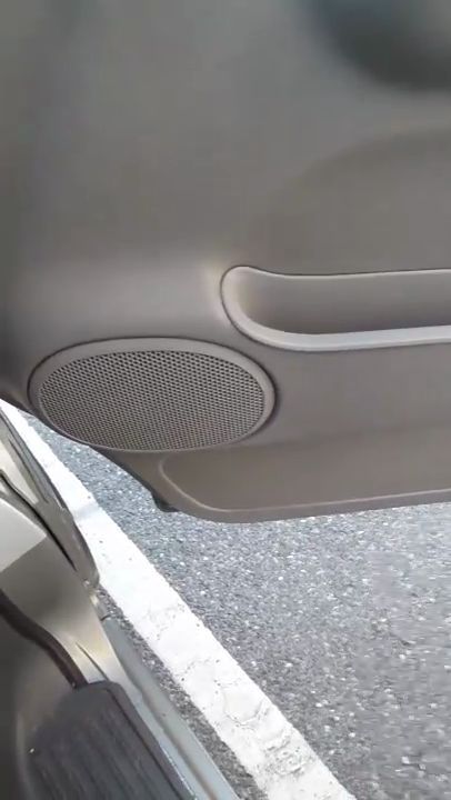

That is quite loud. As it happens while stationary, you can rule out anything drivetrain, suspension or brake related. It sounds a bit like a noisy tappet but it's not regular as you would expect. My advise would be to pop down to nearest Machine Mart and get yourself a stethoscope and use it to work your way around the engine from above and below to narrow it down to a particular area.
http://www.machinemart.co.uk/shop/produ ... tethoscope
Brilliant tool, but you scare yourself with the amount of rumbling, whiring and grinding you will hear.
