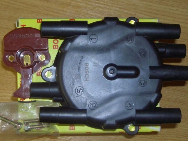

If the plugs are wet the system is injecting petrol .. BUT .. is it getting it at the right time ..??
I have never stripped a Mazda V6 down but you can get the cams (valve timing) set up OK .. but with the rotor pointing the wrong way ie: 180 degrees out .. with the rotor pointing to number four instead of number one ..
On the compression stroke Firing order .. One - Six - Two - Four - Three - Five
