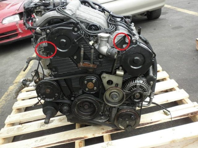

Is the the engine in a Maxda 626 v6 the same as the Bongo v6? and more importantly, will the plug lead set fit a Bongo v6? I have been offered a set and like to know before I take it all apart.

Doesn't appear to be the same engine, as to if it would fit you would need to know the lead lengths I guess.

The plug leads on the 626 seams a lot longer than the Bongo's ..
626 ..
Bongo ..

Did you notice that the 626 is TOTALLY different (if that is a 626 engine in the picture. The distributor is in a different place, the belts are on a different routing, and the induction piping / castings are totally different.....Errrrrr....they aren't the right plug leads!
