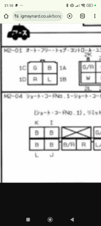

I know this is old but does anyone have the labeled image a for the four pins on the controller plug as the link goes to a flash enabled site that no longer works!

Post by Wpserle » Fri Jun 13, 2025 9:51 pm
Figured it out from the wiring diagram someone else shared
Top / bottom for one direction
Diagonal for the other
I think!
Can hear the motor operating a tiny bit in each direction... I'm hoping if I keep cycling it may magically fix itself...
Rain stops play will try again tomoz!
