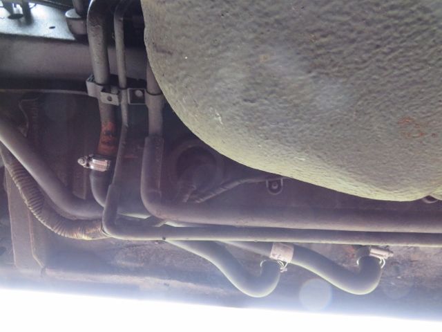

There should be a second drain tap in the large bore metal pipe that feeds the top hose .

Thanks Haydn - that sounds like what is being referred to in the workshop manual. Is it actually anywhere near the rear heater? The confusion could have been caused by references years ago on here to there being a drain plug for the rear heater. On seeing a second one mentioned in the workshop manual, i would naturally have thought it was the one being flagged up on here.haydn callow wrote:There should be a second drain tap in the large bore metal pipe that feeds the top hose .

Re: Draining coolant system...
Found the picture! Rear heater hoses ....mikeonb4c wrote:Thanks Haydn - that sounds like what is being referred to in the workshop manual. Is it actually anywhere near the rear heater? The confusion could have been caused by references years ago on here to there being a drain plug for the rear heater. On seeing a second one mentioned in the workshop manual, i would naturally have thought it was the one being flagged up on here.haydn callow wrote:There should be a second drain tap in the large bore metal pipe that feeds the top hose .
The top hose metal pipe that Haydn mentions runs from the front of the engine bay into the bonnet area. In the photo, light from the drivers seat opening is just reflecting top left, so some way from the front of the engine.
Chris with BertieB
