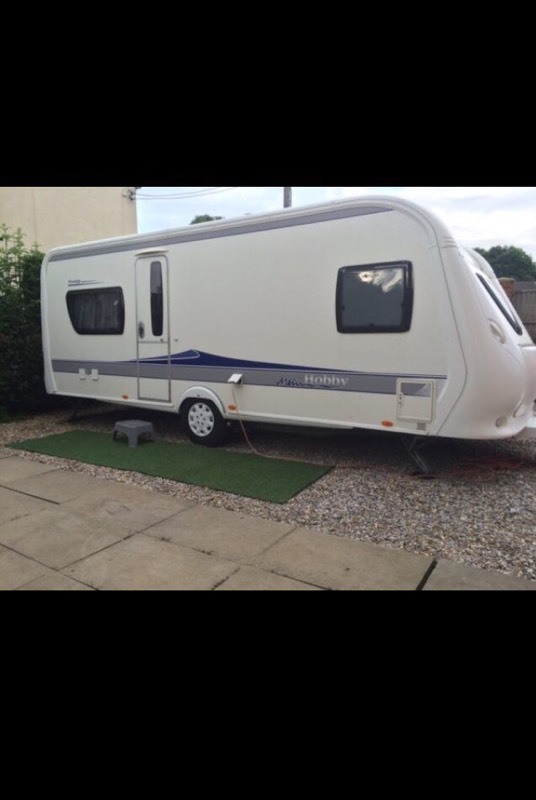

Off to see this van Wednesday :D if the price is right ?
https://i.ebayimg.com/00/s/ODAwWDUzNg== ... 0/$_86.JPG
